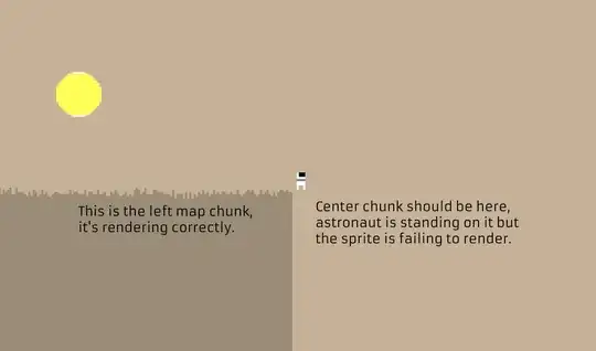

Screenshot
If I comment out the line that blits left_chunk, it changes to this:
Screenshot After

  • Are you sure that your calculated X values position the image in the visible area of the screen? – Zack The Human Oct 22 '12 at 18:07
  • @ZackTheHuman They are partially offscreen, since the screen is only 300x175 and the map chunks are 512x512. I thought that may have been the problem at first, but whether they are onscreen or not seems to be irrelevant to whether it is rendering correctly or not. I can upload a screenshot to help illustrate the problem. – n s Oct 22 '12 at 18:10
    The SDL documentation says that SDL_BlitSurface saves the final rectangle to dstrect after blitting. Have you tried reseting the where variable after each blit? – Asakeron Oct 22 '12 at 18:39
  • @Asakeron That was it! I didn't expect where to be modified. You should make your comment an answer! – n s Oct 22 '12 at 18:42
The SDL documentation says that SDL_BlitSurface saves the final rectangle to dstrect after blitting. Reseting the where variable fixes the problem.
