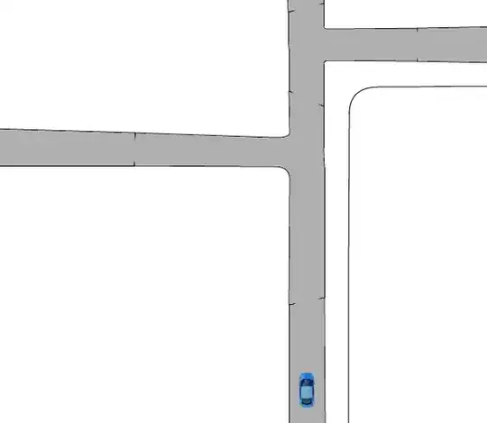

Top down overview
Car waiting to take the turn

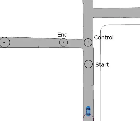

Waypoints
Move the car in a linear path(straight line) from the bottom to the 'Start' point. Now use a Bezier to get the car to the 'End' point through the 'Control' point. Use another linear path moving straight from the 'End' to the last point on the left.

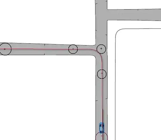

The resulting path
Resulting motion path

To calculate the control point, use the x-value of the point that is directly bellow or above the turning point and the y-value of the point directly to the left or right of the turning point.
If the roads do not form a straight angle, simple draw an imaginary line through both roads and use the intersection as the control point. You can take a smoother turn if you pull the start & end points away from the control point.
