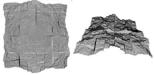

I've implemented a diamond-square algorithm according to this article: http://www.lighthouse3d.com/opengl/terrain/index.php?mpd2
The problem is that I get these steep cliffs all over the map. It happens on the edges, when the terrain is recursively subdivided:
Here is the source:

  • Without looking hard at your code, it looks like you probably have the wrong corners in the wrong calls in the 4 recursive calls at the end. The map looks like each square is rotated/flipped before calculating the next set, thus sub-dividing the map on strange cliffs. The bottom edge of the top right square looks like it matches the right edge of the top left square, and so on. – DampeS8N Sep 20 '12 at 14:04
  • I'm not sure what you mean. The center of the coordinate system is in the top left corner, x axis points to the right and y down. So in the first iteration (x1=0,y1=0),(x2=128,y2=128) and (x1+hx=64,y1+hy=64) is the center of the square. The square is thus divided into 4 subsquares: ((0,0)(64,64)),((64,0)(128,64)),((0,64)(64,128)) and ((64,64)(128,128)). Looks fine to me... – kafka Sep 20 '12 at 14:45

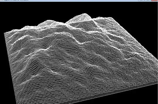

Here's my code and the output: .
void DiamondSquare(unsigned x1, unsigned y1, unsigned x2, unsigned y2, float range, unsigned level) {
    if (level < 1) return;
    // diamonds
    for (unsigned i = x1 + level; i < x2; i += level)
        for (unsigned j = y1 + level; j < y2; j += level) {
            float a = m_heightmap[i - level][j - level];
            float b = m_heightmap[i][j - level];
            float c = m_heightmap[i - level][j];
            float d = m_heightmap[i][j];
            float e = m_heightmap[i - level / 2][j - level / 2] = (a + b + c + d) / 4 + GetRnd() * range;
    // squares
    for (unsigned i = x1 + 2 * level; i < x2; i += level)
        for (unsigned j = y1 + 2 * level; j < y2; j += level) {
            float e = m_heightmap[i - level / 2][j - level / 2];
            float f = m_heightmap[i - level][j - level / 2] = (a + c + e + m_heightmap[i - 3 * level / 2][j - level / 2]) / 4 + GetRnd() * range;
            float g = m_heightmap[i - level / 2][j - level] = (a + b + e + m_heightmap[i - level / 2][j - 3 * level / 2]) / 4 + GetRnd() * range;
    DiamondSquare(x1, y1, x2, y2, range / 2, level / 2);
http://i.imgur.com/laBhN.png
