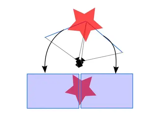

Is there any resource location on how to view a 3D scene from an application or a game on multiple windows or monitors? Each window should continue drawing from where the neighbouring one left off (in the end, the result should be a mosaic of the scene). enter image description here My idea is to use a camera for each window and have a reference position and orientation for a meta-camera object that is used to correctly offset the other cameras (e.g. like in the above figure where the render targets of the two cameras reproduce the star when stitched together). Since there are quite some elements to consider (window specs, viewport properties, position-orientation of each render camera), what is the correct way to update the individual cameras considering the position and orientation of the central, meta-camera? I currently cannot make the cameras present the scene contiguously (and I am reluctant in working out the transformations without checking whether this is the actual way of doing things).

  • Would this recent answer be useful? http://gamedev.stackexchange.com/a/34957/11844 – Eric Aug 28 '12 at 10:26
  • Yes and no: it confirms that multiple cameras are to be used, but gives no hints on what the actual steps of updating such a CAVE system containing multiple cameras should be (how the cameras are positioned and oriented w.r.t. to each window's properties (fov, viewport settings, etc.) ). Perhaps I have to derive the equations by hand and then see whether they're complicated or kind of easy to understand (relative transformations are easy, but viewport computations are not my strong point currently, hence my question in this form). – teodron Aug 28 '12 at 11:04

Now choose or let the user choose a "center" screen, this will be your camera pointing straight forward. The other screens' positions and rotations should relative to this one.
To move your entire camera setup through the world, first apply the relative translation and rotation to the two other cameras, then apply the center camera's translation and rotation to all three. This will keep your peripheral cameras in the same relative position as your center camera moves.
Now, usually you might just use the render target's resolution to set up the camera's screen size in the world. However, if instead you make the virtual size proportional to the individual screen's physical dimensions, content will appear at the same size on each screen, accounting for different pixel densities.
To make the user input easier, I suppose you could have 3D representations of the screens and let the user manipulate their properties directly, or relative to each other. (for example, allow "hinging" the secondary screens to the center one, to make adjusting the rotation easy while maintaining the aligned bezels).
Edit: As for the FOV, depending on if you use horizontal or vertical (or both, or diagonal) FOV, a screen with a wider physical size should have a proportionally wider FOV.
If you also let the user specify a rough position from which they will be viewing, this eliminates guessing though and you can just calculate the viewing angles and hence FOV for each screen from that.
  • Nice answer, thanks. I guess there are two options: 360 view where the cameras have a common center and "wide" where the cameras are parallel to each other (sharing a translation line). – teodron Aug 28 '12 at 16:03
  • I suppose so, yeah. With more than two screens though there doesn't have to be a single point that gives you a perpendicular view of each screen. Ideally the user would have it set up like that, or close, but you may or may not want to allow a 3rd scenario where there is neither a common center nor are all screens aligned to a plane in your virtual representation –  Aug 28 '12 at 16:13
