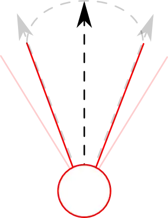

What is a fast way of limiting the heading vector to a certain angle so that it turns in greater distance relative to the limit.
A smaller cone/angle should make the object take a far bigger curve to traverse to reach its goal where a larger cone/angel allows the object to rotate faster in the direction of its goal.
If there are some vector tricks i'll be glad to know them!

  • Are you asking how to constrain a vector to the inside of a cone, or are you asking about how to limit turn rate? (Limiting the turn rate based on a cone like this could make your turn rate very frame rate dependent) – Cholesky Nov 20 '12 at 21:10
  • In this case both are somewhat similar. The cone represents the limit ( regardless of the angle )which limits the turning angle. – Sidar Nov 20 '12 at 21:39

  • I assume that targetPosition-currentPosition are in this case vectors or the result should be applied as a vector against the currentDir to calculate the angle. What about turning the object left or right by using the cross product ( in 2D btw ) but then limit heading vector instead of calculating all that you described. Could you elaborate on this? – Sidar Aug 26 '12 at 19:37
  • I was refering to this btw for cross-product: http://gamedev.stackexchange.com/questions/7131/how-can-i-calculate-the-angle-between-two-2d-vectors – Sidar Aug 26 '12 at 19:46
  • tgtPos and currPos are vectors (actually, call them 3D points for less ambiguity), so tgtPos - currPos is the desired direction (modulo a normalization). Your currentDir needs to be rotated to be aligned with the desiredDir. Taking the cross product between currentDir X desiredDir you find the axis against which you need to rotate the current advance direction. From hereon, you may want to compute the maximum allowed turn angle for your current speed and then rotate being careful not to exceed this angle, if that's the case (i.e. turn too sharp). – teodron Aug 27 '12 at 06:31
