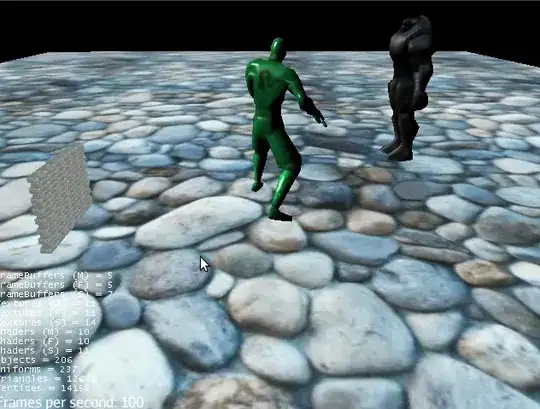

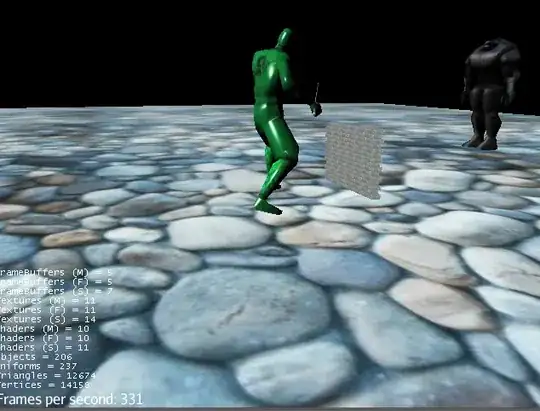

I.e. in this case should I use jME3 or some other engine (I heard Unreal offers a free engine) for a 3D dungeon game and when I build up the dungeon, should I use an algorithm for a new dungeon every time or should I use a static scene?
I've code to build a small wall that adds it to my scene which is mostly programmaticly achieved with less 3D modelling and more algorithmic solutions:
  /** This loop builds a wall out of individual bricks. */
  public void initWall() {
    float startpt = brickLength / 4;
    float height = 0;
    for (int j = 0; j < 15; j++) {
      for (int i = 0; i < 6; i++) {
        Vector3f vt =
         new Vector3f(i * brickLength * 2 + startpt, brickHeight + height, 10);
        makeBrick(vt);
      startpt = -startpt;
      height += 2 * brickHeight;
  /** This method creates one individual physical brick. */
  public void makeBrick(Vector3f loc) {
    /** Create a brick geometry and attach to scene graph. */
    Geometry brick_geo = new Geometry("brick", box);
    brick_geo.setMaterial(wall_mat);
    rootNode.attachChild(brick_geo);
    /** Position the brick geometry  */
    brick_geo.setLocalTranslation(loc);
    /** Make brick physical with a mass > 0.0f. */
    brick_phy = new RigidBodyControl(2f);
    /** Add physical brick to physics space. */
    brick_geo.addControl(brick_phy);
    bulletAppState.getPhysicsSpace().add(brick_phy);
