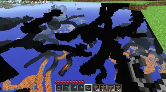

Minecraft's caves are generated by "perlin worms" method. The generator snakes through terrain and caves out a tunnel. Minecraft does not use 3d perlin noise for cave generation, because it tends to leave unconnected pockets in the terrain. Minecraft caves have not been generated through 3d Perlin noise since very early Alpha versions.

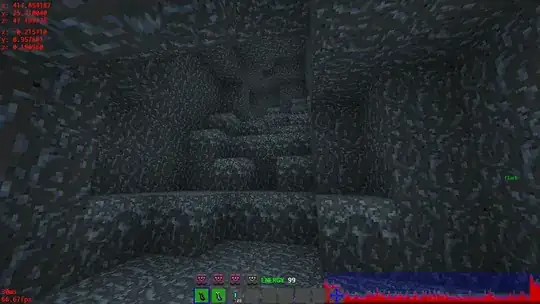

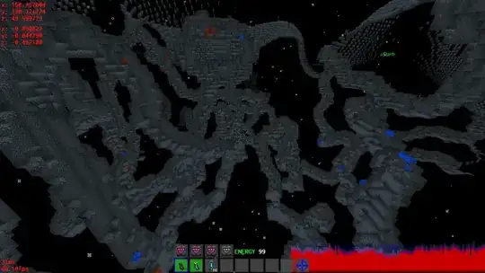

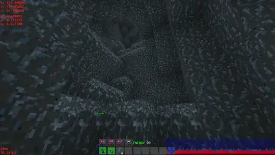

Here are caves in Gnomescroll generated from the "perlin worm" method.
Gnomescroll Cave System First Person View 1
Gnomescroll Cave System First Person View 2
Gnomescroll Cave System Third Person View 2

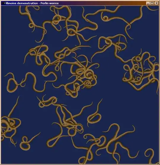

These are the libnoise "Perlin Worms" from the libnoise tutorial. The technique closely reproduces the caves generated in Minecraft.
Linoise Tutorial Perlin Worms
The snaking parameters affects the quality of the cave system and determine how vertical the caves are and how fast they change direction. Caves in minecraft branch and the radius of the cave tunnel is varied over the length of the caves.
