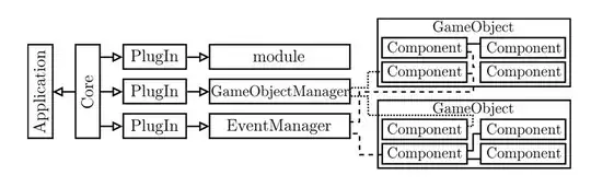

An example for an application based on a core engine providing a plug-in based framework for cluing everything together in a component based game object management model. Each subengine (rendering audio) is a module added to the game engine as plug in. Each component can be part of a subengine/module. And the (component based) game object management is the connecting link between the seperated modules.
