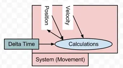

The System
The lock only works if our key has teeth for both position and velocity. This system only processes entities that have a position and a velocity. There are multiple ways to set up how these systems recognize which entities to process, but one way is to use a long
. Each bit is reserved for a component type. For our example lets assume a 4 bit type instead of a 64 bit long. Our example entity would have all available components. So it's key would be 1111
. Then, the system is looking for any entity that has a 11--
. (The -
represent don't care, because movement doesn't care if there's a sprite or health). It can check an entity with a simple AND
operation. So our entity matches if ((1111 & 1100) == 1100)
. If I lost you there check out some more about bitwise operations.
As you can see, systems have access to outside resources. They can access the time, graphics, sound and so on. They are simply little processors that take one key at a time, and process data. You see that the movement system takes the velocity, delta time and position; then does some calculations and stores the result back into position.
The entity keys are really easy to generate. You can add or remove them at will. The entity doesn't care, it's just a way to group and hold the components. The components have no interdependence. The closest the components get to interacting with each other is when a system operates on them and uses data from one to update another, like our movement example.
