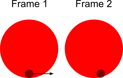

In one of my projects I have a game area in the shape of a circle. Inside this circle another small circle is moving around. What I want to do is keep the small circle from moving outside the bigger one. Below you can see that in frame 2 the small circle is partly outside, I need a way to move it back to just before it is about to move outside. How can this be done?
Basic example
Also, I need the collision point along the arc of the big circle so that I can update the small circle's velocity. How would one go about calculating this point?
What I would like to do is before moving the small circle, I predict its next position and if it is outside I find the time of collision between t=0 and t=1 (t=1 full time step). If I have the collision time t then I just move the small circle during t instead of a full time step. But again, the problem is I don't know how to detect at that time the collision occurs when it comes to two circles and one being inside the other.
EDIT:
Example of collision point (green) I want to find. Maybe the picture is a bit off but you get the idea.

  • Thanks, it does look elegant but I am not quite sure I understand. For example: "just find the point D on BC at distance R-r of A". I drew a picture to try to understand better. So if we start at B (A.X, A.Y-(R-r)) and C is where we will end up with the current velocity. The way I understand the quoted text: Find a point D on the line segment BC that is a distance of R-r away from A. But the way I see it on the picture I drew is that only exactly B is R-r away from A. All others points will be > R-r away from A. What am I missing? – dbostream May 26 '12 at 17:04
  • @dbostream You aren't missing anything. If the two circles are already in contact then there is no real collision to detect: the collision happens in B, and k=0. Now if it is collision resolution you want, I haven't covered that in my answer because it would require knowledge about the physical properties of the objects. What is supposed to happen? Should the inner circle bounce inside? Or roll? Sweep? – sam hocevar May 26 '12 at 20:31
  • I want the small circle to start sliding along the arc of the big circle. So if I am not mistaken I want the collision point on the arc of the big circle so I can use its normal to update the velocity. – dbostream May 26 '12 at 22:49

  • Thanks, but is it really correct to shoot a ray from the center of the small circle when doing that intersection test? Won't we end up with the scenario in the middle of this picture? I mean the first point on the arc of the small circle to collide with the big circle is not necessarily the one on the arc in the direction of speed. I think I need something like in the bottom scenario of the picture I linked to. I have added a new picture in the first post showing an example of what I think I need. – dbostream May 26 '12 at 14:31
  • Hmm I suppose that scenario is possible. Maybe test with a new circle C that has B.Radius + the max movement of B this frame, check if that collides with A and then workout the point on C that is furthers from A. (Haven't tried this btw) – Roy T. May 26 '12 at 16:50

  • @Darkwings Thanks, I drew a picture, this is how I interpreted your explanation. As you can see in the picture, B is outside so it has to be moved inside. The collision point seems to be at F which will position circle B at point E. But you say the collision is at point C (...starting to suspect my drawing is wrong) which would position circle B at point D. Assuming E is correct the remaining distance (BE) to travel will be in the form of sliding towards the point D. Comments? – dbostream May 28 '12 at 19:32
  • Sorry, looking at previous pictures I was assuming the circle B were going to start on the border and you wanted to let B move within the bound, so the resulting C is where the small circle would roll. For the general case you'd be better off with a Minkovski sum (look at the other answer) to avoid more messy calculations. – Darkwings May 28 '12 at 19:56
  • @Darkwings, ok thanks anyway. Just a question about the collision scenario in my drawing, would it be (completely) wrong to move circle B to point D as a sliding response? It would keep circle B inside circle A but I guess there is some error involved since it seems too easy. :) – dbostream May 29 '12 at 07:27
  • It's not an 'error', it's just an approximation, and it could be enough for what you need to do. It's the difference between a realistic simulation and 'something that feels right'. For something highly accurate you may want something like this: http://www.wildbunny.co.uk/blog/2011/03/25/speculative-contacts-an-continuous-collision-engine-approach-part-1/ – Darkwings May 30 '12 at 13:03
