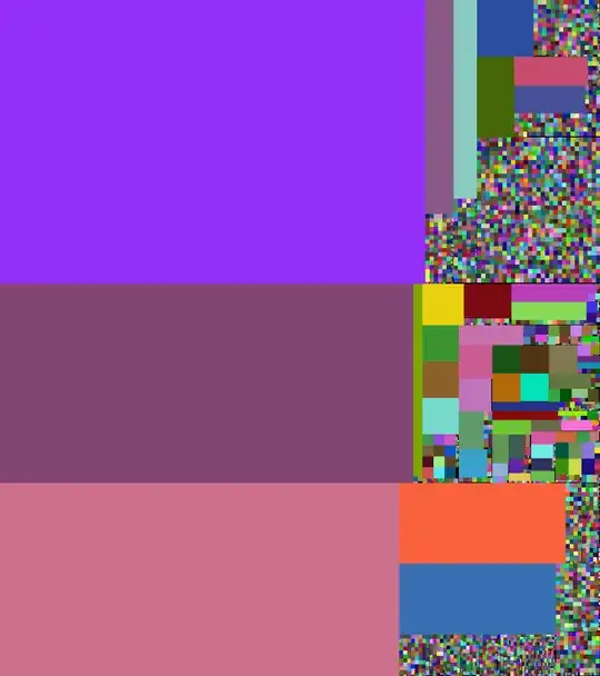

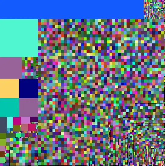

If anyone is still interested, I have completely rewritten the rectpack2D library so that it is way more efficient.
It works by keeping a std::vector
of empty spaces in the atlas, beginning with some initial maximum size (typically, the maximum allowed texture size on a particular GPU), splitting the first viable empty space and saving the splits back to the vector.
The performance breakthrough came with just using a vector, instead of keeping an entire tree, like it was previously done.
The procedure is described in detail in the README.
The library is under MIT, so I'm happy for you if you find it useful!
Example results:
Tests were conducted on a Intel(R) Core(TM) i7-4770K CPU @ 3.50GHz. The binary was built with clang 6.0.0, using an -03 switch.
Arbitrary game sprites + Japanese glyphs: 3264 subjects in total.
Runtime: 4 milliseconds
Wasted pixels: 15538 (0.31% - equivalent of a 125 x 125 square)
Output (2116 x 2382):
In color:
(black is wasted space)
Japanese glyphs + some GUI sprites: 3122 subjects.
Runtime: 3.5 - 7 ms
Wasted pixels: 9288 (1.23% - equivalent of a 96 x 96 square)
Output (866 x 871):
In color:

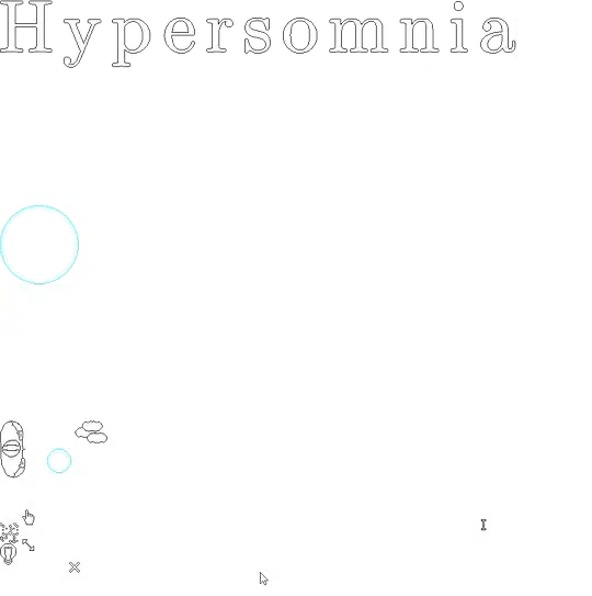

Here's a sample visulization of the output for my packer on a random set of images from my website image dump directory :).
The numbers in the squares are the id's of the containing blocks in the tree so give you an idea of the order of the insertions. The first is ID "3" because it is the first leaf node (only leaves contain images) and consequently has 2 parents).
Root[0]
Child[1] Child[2]
Leaf[3]
