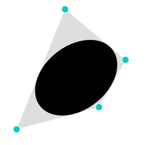

I already answered the question How to project a 3D circle/ellipse to 2D? by providing the JavaScript implementation below.
Christopher Brierley Jones describes the process on his website how an ellipse can be fit perfectly into any convex quadrilateral.
So one way to compute the 2D equations of 3D circular arcs, without discretizing into line segments first, is to project the bounding rectangle and the extract the ellipse parameters from the resulting convex quadrilateral as described by Jones.
You can see a live demo here or a video here
Now if you want to project a sphere instead of a plain circle from 3d to 2d the steps would be:
  1. create a circle with the same center as the sphere and the same radius but oriented with it's normal towards the camera plane, i.e. that the circle's plane is parallel to the projection plane As DMGregory pointed out the correct orientation for the circle face is not parallel to the projection plane but instead facing the camera center, as illustrated in this diagram.
  2. so instead: create a circle with the same center as the sphere and the same radius but oriented with it's normal towards the camera position
  3. create a bounding square around this circle
  4. project the 4 vertices of this square with the camera projection matrix to obtain a quadrilateral
  5. reconstruct the ellipse parameters by applying the procedure below to the resulting quadrilateral
