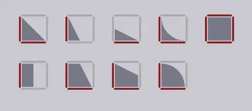

As usual I'll just throw a few ideas to the table. There are certainly several ways you can approach this problem. I'll describe the three I managed to remember, and it's up to you to decide which (if any) of these approaches is good for your project.
Idea 1: Repeatable patterns in your tiles
Does your system need to be flexible enough to support any conceivable collision area, or can you possibly break it down into a finite set of tile shapes that you can build with, and treat them as special cases? Here's a pair of resources to read up on this idea:
