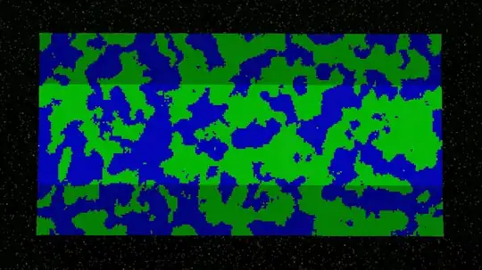

Below is an example of the spherical mapping results.
A "flat" map:

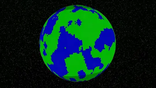

And a spherical world, created by wrapping the vertices into a sphere:
Note that there will be a large amount of distortion at the poles if you don't follow the suggestion above to limit the surface area of the sphere this map is stretched over.
