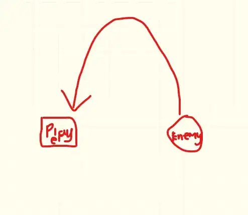

I want to create a projectile that fires upwards and in a sense falls down onto the player, like this:
I found through some research I needed to use a "parabolic" equation. However it wasnt very clear how to implement this.
