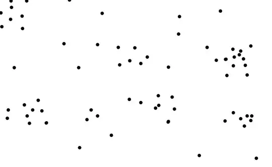

I have a 2D grid of cells in Unity, and each cell can be on or off. I want to randomly generate the on cells, and when I just assign a probability to each cell, the entire grid has the same density, looking something like this: enter image description here
But I would like different densities for random areas, something more like: enter image description here
Is there some kind of algorithm to make this random generation possible?

  • Have you looked into Mathf.PerlinNoise as a way to vary the spawn probability over space in a smoothly-varying way? – DMGregory Dec 28 '23 at 02:27
  • In this answer I show how to use Poisson-Disk sampling to get a very similar result. That solution uses Perlin noise to guide the probability rate (much as DMGregory suggested). With some minor changes it could be adapted to use your on/off cell grid. Is that enough to address your question? – Pikalek Dec 28 '23 at 03:30

You can just set the densities probability to each area so you will get result close to your second picture. Write the algorithm to separate the gird on areas. for example you have 8x8 grid and areas:
11122333
11122333
44422555
44466555
44466555
77888888
77888888
77888888
Generate probablity for each area: 1)p=80% 2)p=30% 3)p=45% etc. And you can customize it for your needs.
