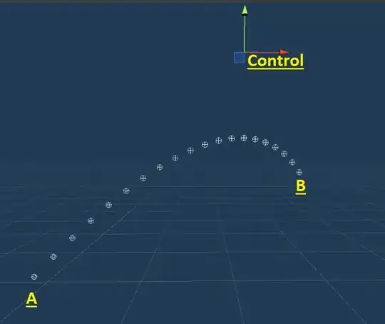

I'm moving a projectile to it's target along a Bézier curve with one control point.
The projectile moves from Transform A to Transform B with the curve created by control's Transform's position. I'm using this method so that I can change how the projectile's arc or path looks depending on the enemy's position.
The issue:
The projectile travels from A to B successfully, however, my issue is depending on the curve the speed can be inconsistent and an unwanted 'easing' effect can occur.
Here's an example in the image below. Because of control's position, you can see the wirespheres begin to bunch up and smoosh together. As the projectile travels from A to B, it will gradually move slower as the wirespheres become closer together.

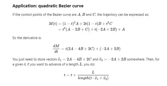

I believe v1= ac & v2 = cb. Would L be a number I pick that would decide how much it moves each frame?(almost like speed)
I imagine Length is separate from L. If so, what would Length be?

  • @Adam, I think I might be close to figuring this out, but could really use help with clarifying a few things. I believe v1= ac & v2 = cb. Would L be a number I pick that would decide how much it moves each frame?(almost like speed)
    – PayasoPrince Nov 25 '23 at 23:01
  • Just to help with confustion, I believe that's how the answer provided in the mentioned above post should be interpreted:
    • L is the speed at which objects is moved each simulation step
    • length in the denominator is not a variable, but a function. So it should be read as divide L by length of vector (t * v1 + v2).
    Also, I am not sure why you've assumed v1 = ac & v2 = cb. These vectors are parts of curve's deriviative, and, if I am reading that correctly, should be: v1 = 2 * A.position - 4 * Control.position + 2 * B.position, and v2 = -2 * A.position + 2 * Control.position
    – Daniil Dubrovsky Nov 27 '23 at 00:30
