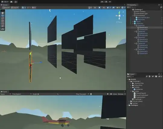

I'm currently working on my first Unity Learn code challenge, making a Flappy Bird style game where a plane needs to fly through gaps between wall obstacles.

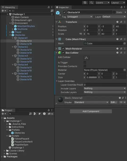

I've successfully implemented all the required features except for one: I want to add colliders to my obstacle prefabs, but I'm having trouble making them work. I've added colliders and a rigidbody, but the plane continues to fly right through the walls instead of stopping.
I utilized three scripts: PropellerSpin, PlayerController, and FollowPlayer for the camera.

Game and scene view Hierarchy and Inspector windows

  • I think your issue might be the same as the one described in this question: Car driving through walls with Transform.Translate. Moving a physics object with its transform component is not appropriate if you want the physics engine to be able to interrupt that movement. Use the Rigidbody. – DMGregory Aug 04 '23 at 15:49
  • Have you had any luck applying the fixes recommended in the linked Q&A, or do you need any specific help with it? – DMGregory Aug 05 '23 at 15:43
  • I haven't tried it yet. The rigidbody from the editor didn't work; it appeared below the plane, and it's supposed to cover the shapes of the obstacles, right? The weird thing is that when I touch it to modify the scale or position, it touches the obstacles but makes no changes to them. – Mila Data Aug 06 '23 at 03:34
  • Rigidbodies have no visual appearance or spatial extents of their own, so I don't know what you mean by "it appeared below the plane" or "it's supposed to cover the shapes of the obstacles" — are you talking about a collider component of some kind instead? Again, remember that "doesn't work" or "no change" are not enough information to document an issue: what change were you expecting? How did the observed results differ from that expectation? – DMGregory Aug 06 '23 at 07:02
  • I'll come back to this project soon, I'll let you know when. Thank you very much, It seems I was confusing Rigidbodies with colliders then, I'll see it soon. – Mila Data Aug 14 '23 at 15:40
