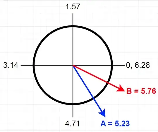

I have a 2D sprite with a rotation (let's call it A), and I want to slowly rotate it until it's at a new rotation (B). Depending on where A is, I'll rotate right or left, which ever gets me to B faster. A is constantly changing as it rotates towards B, and B is also able to change.
I'm currently taking the difference of B - A, and rotating left (CCW) if it's positive, and rotating right (CW) if it's negative. This almost works, but breaks when the target crosses the boundary at 0/ and changes signs.
In the first image, you'll see how my current logic works as expected:
B - A ≈ 5.76 - 5.23 = 0.53 = turn CCW.

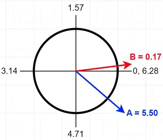

But, if B continues to rotate left, it will rotate past and result in the sprite turning CW, which is slower than turning CCW:
B - A ≈ 0.17 - 5.50 = -5.33 = turn CW.
Any ideas would be appreciated, thanks!

The maximum amount you should ever rotate is half a turn, since if you're rotating more than that, it would have been faster to go the other way. You should check your final result to see if it its magnitude is greater than Pi. If it is, your "shortest path" is greater than half a rotation, indicating that you have a modulo issue and need to add 2*Pi to B.
In your example, a result of -5.33 is almost one full turn, which obviously isn't the fastest way to reach a heading. Since 5.33 is greater than pi, add 2*Pi to the result, yielding a value of 0.95, which is the correct minimum distance to turn counterclockwise.
