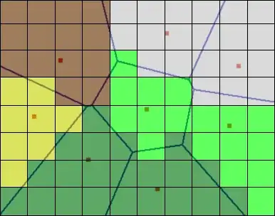

(big edit) I will make this a much more clear for what map-generation concepts you need to apply. Use a coordinate system with 1 unit per screen, in floating point values. Generate a small random set of points within these coordinates, as if you were making a Voronoi diagram but we won't actually make the random shapes. Instead the diagram will be implied and approximated by the map after the biomes are set.
Each point is the center for each biome area. Set your own rules to associate a point with a biome. For instance if you want a desert to the east and not too far south or north, all points which are greater than a certain X value and within a certain Y range will have desert surrounding them.
Associate each screen with one of these point, which is done by taking the center of the screen in XY coordinates (say 4.5, 8.5) and returning the point closest to the screen's center.
Here's a rough drawing of a shape diagram on the grid of screens. We aren't really concerned with the lines surrounding the shapes, but they're there to illustrate how the screens start to approximate the shape regions.
Voronoi-grid
Repeat for each screen, giving each one its own biome.
