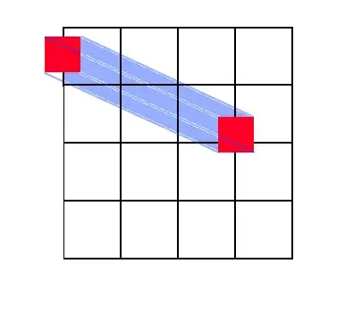

The Easiest way is to update your world twice(or more) every cycle. using this method you can increase your max speed 2 or more times.
The more Universal way to do it but is to check collision of the shape generated by the moving object, with all the tiles. something like the picture below while red box moves collision is checked for every square in map and the blue area (which is a polygon generate by convex hull algorithm):
collision sample
physic engines usually have a support for such a feature, to check continues space for movement. for example in box2d there is a member (isBullet) which indicates if engine should use continues movement checking.

  • Thanks for the answet. I already use a sweep test algorithm which it's working really greay, anyhow I will have in mind this algorithm for future projects. – oscar.rpr Dec 10 '11 at 14:02
  • well, what I said was just using sweep algorithm for any polygon, or at least how I know sweep is implemented for none trivial shapes. – Ali1S232 Dec 10 '11 at 17:24
