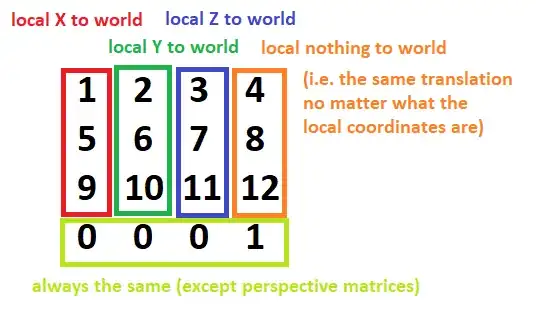

Your rotation matrix tells you which world axes are the object's local axes. You can directly read these vectors from the matrix without any processing:
annotated matrix
If you want to see which world direction is the object's local X direction, just read it directly from the first column of the matrix. The second column tells you the Y direction, and the third column tells you the Z direction. You can also see how the translation is the "local nothing direction".
(note: I think this is right, but I always get matrix order confused, so it might actually be the first row)
