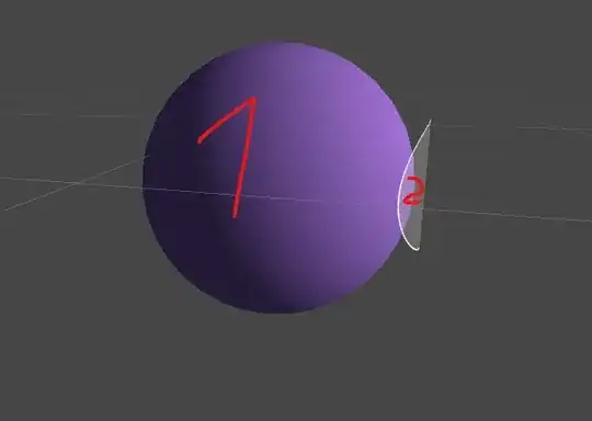

I have a camera that is looking at an object with render texture output and I use that render texture on raw image in UI.
Object itself has 2 parts:
  1. the ball
  2. kind of a semi transparent mask.
And this is an output: enter image description here

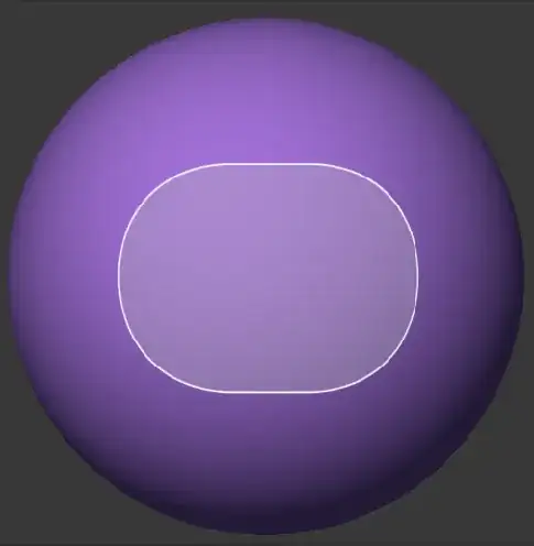

The star is there just for the reference. Problem is that part behind the second object is also transparent on render texture like it is see-through. I need that object transparent in relation to the ball (object one) but I don't want my texture to be see-through.
This is the result I expect:

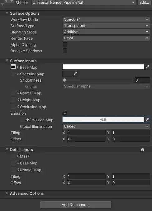

I did manage to fix this kind of by changing my Material blend mode to additive and playing with emission color to get the mask part right. Here is my material:
