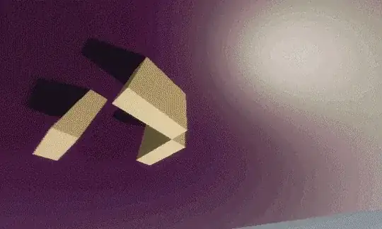

Demo GIF
I have a smooth 6DoF controller from following a tutorial (this is the tutorial) and tweaked it to be exactly what I want with a few exceptions.
I found myself wanting the ability to lock the horizon line by pressing a toggle button so while the player is freely rotating around the horizon stays level until the lock is disabled.
I'd also like to have a button that smoothly rotates the horizon to be level with the Ship object/camera but keep the yaw and pitch the same. I'm not sure how it would work but I want this button to simply smoothly upright the Ship when the button is pressed once and have the horizon lock be a separate optional feature.
I have no idea where to even start on the math/logic for these two features but I have the buttons and functions mapped already hoping I might just gleam someone's smarter code and just having it magically work eventually. I have a feeling there's a better way of going about this than guessing or trial and error haha.
The entire script for the Ship object is self-contained and I'll put it here along with some images and GIFs of various hopefully useful details.
As an aside, I'm sure there's a simple solution I'm overlooking but the ship does roll when colliding with other objects (spherical collision mesh). Is there a way to either disable it or have less friction?

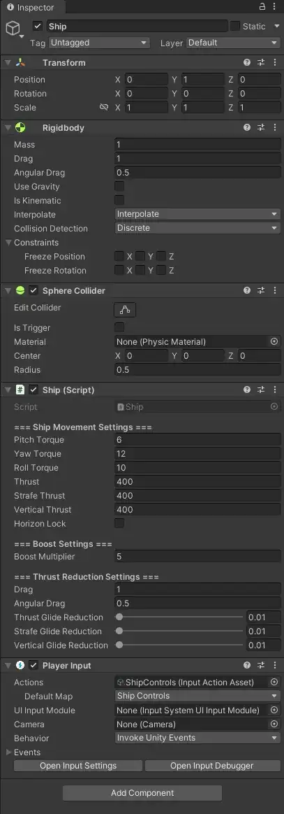

Inspector Window for the Ship object.
Inspector window for ship
