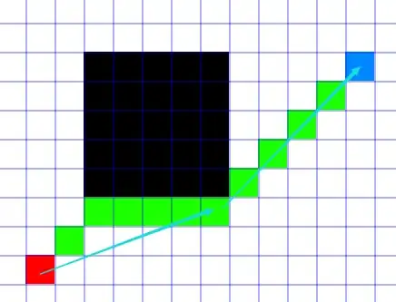

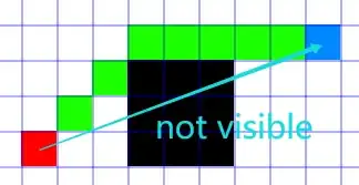

  1. The basic strategy is to check if the nodes of the path obtained by pathfinding are visible between them, and if they are visible, delete all nodes between them. Two nodes are visible if the line between them does not pass through the block. enter image description here enter image description here

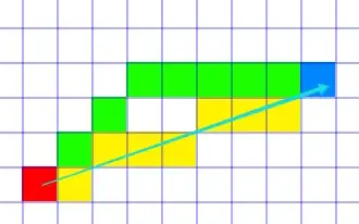

  2. Bresenham's_line_algorithm is used to rasterize the straight line represented by the geometry into grid coordinates. In this way, we can get the coordinates that need to be detected. enter image description here
  3. If all the coordinates that need to be detected(The yellow grids in the picture above) are not blocking, then it can be seen that the two nodes are visible.

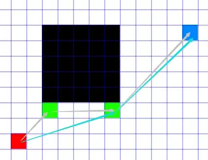

  4. How to check the whole path? A locally optimal strategy is to start from the starting point, find the visible point farthest from the current point, and then set this point as the current point to repeat until the current point is the end point. enter image description here
