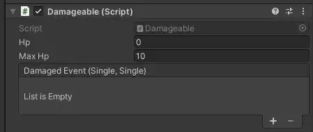

When you now look at the inspector of a gameObject with that component, then you will see that you have a new widget as you might know it from buttons in the input system:
Damageable Inspector
You can now add any methods from any components of any gameObject to it (as long as the signature matches). For example, here is a component that controls a health bar:

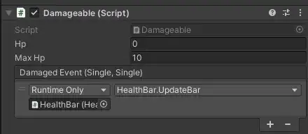

Note that it does not reference the Damageable script. But it has a method "UpdateBar" which takes two floats, just like the UnityEvent. That means we can use the inspector to bind this method to the event of the damageable object. Just go to the inspector of the event, click the "+" icon, assign the health bar to the "Object" field and select the function "HealthBar->UpdateBar" in the function dropdown. It should now look like this:
Damageable Inspector 2
Now when the damageable invokes the damagedEvent, the health bar gets updated. Without the health bar knowing that the Damageable exists, or the Damageable knowing about the health bar. That's loose coupling!
