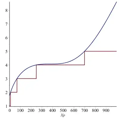

Tables can structure progression exactly but they take up space and formulas can be fast and accurate enough, so they are options too.
The XP table [ Lv1⟼0 , Lv2⟼10 , Lv3⟼70 , Lv4⟼250 , Lv5⟼700 ] example has Lv(-∞)=...=Lv(8)=Lv(9)=1, Lv(10)=Lv(11)=...=Lv(68)=Lv(69)=2, Lv(70)=Lv(71)=...=Lv(248)=Lv(249)=3, Lv(250)=Lv(251)=...=Lv(698)=Lv(699)=4 and Lv(700)=Lv(701)=...=Lv(∞)=5. It happens when
\$ Lv(Xp)=\lfloor f( clamp( 9 , Xp , 700 ) ) \rfloor \$,
\$ 1 \le f(9) < 2 \$,
\$\left\{ \begin{aligned} 2 \le f(10) < 3 \\ 2 \le f(11) < 3 \\ ... \\ 2 \le f(68) < 3 \\ 2 \le f(69) < 3 \end{aligned}\right.\$
\$\left\{ \begin{aligned} 3 \le f(70) < 4 \\ 3 \le f(71) < 4 \\ ... \\ 3 \le f(248) < 4 \\ 3 \le f(249) < 4 \end{aligned}\right.\$
\$\left\{ \begin{aligned} 4 \le f(250) < 5 \\ 4 \le f(251) < 5 \\ ... \\ 4 \le f(698) < 5 \\ 4 \le f(699) < 5 \end{aligned}\right.\$
\$ 5 \le f(700) < 6 \$
or something like it, so generically rounding is necessary to omit progress between level numbers, f must map to values that make correctly Lv formula (for each valid Xp we have Lv(Xp)≤f(Xp)<Lv(Xp)+1 ⟹ Lv(Xp)=⌊f(Xp)⌋ or Lv(Xp)-0.5<f(Xp)<Lv(Xp)+0.5 ⟹ Lv(Xp)=⌊f(Xp)⌉ or something like) and can clamp.
Watch out for rounding errors. If you make Lv(Xp)=⌊f(Xp)⌋ and try f(10)=2 but code result is f(10)=1.999999999999999778 (minus one bit) then Lv(10)≠2. Since Lv(9)=1 and Lv(10)=2, is better to assume that the level transition experience points is between 9 and 10 (possibly f(9.5)=2 or (f(9)+f(10))/2=2).
The most common is to use easily invertible functions and truncation (the same as rounding down for non-negatives), because defining one formula like this makes the other one obvious. For example, if you decided that Xp(Lv)=10*(Lv-1)³ then Lv(Xp)=uint( cbrt(0.1*Xp) )+1 (or better yet Lv(Xp)=uint( cbrt(0.1*Xp+0.05) )+1 to avoid rounding error).
Another more usual thing is to set a formula and accept the consequent progression, but you can set progression and try to find some sufficiently precise formula with curve fitting, regression, etc. If you want Lv(9.5)=2, Lv(69.5)=3, Lv(249.5)=4 and Lv(699.5)=5 then can find
\$ Lv(Xp) = \lfloor f(clamp(9,Xp,700)) \rfloor \$
such that, for example,
\$ f(Xp) = c_0+^3\sqrt{c_1+(c_2+c_3 Xp)^3} \$
\$\left\{ \begin{aligned} f(9.5) = 2 \\ f(69.5) = 3 \\ f(249.5) = 4 \\ f(699.5) = 5 \end{aligned}\right.\$
because
\$ f^{-1}(Lv) = k_0+^3\sqrt{k_1+(k_2+k_3 Lv)^3} \$
\$\left\{ \begin{aligned} k_0 &= -c_2/c_3 \\ k_1 &= -c_1/c_3^3 \\ k_2 &= -c_0/c_3 \\ k_3 &= 1/c_3 \end{aligned}\right.\$
and the solution is { c0≈-4.18488 , c1≈562.35163 , c2≈-7.05762 , c3≈1/53.70418 , k0≈379.02365 , k1≈-87102824.71339 , k2≈224.74532, k3≈53.70418 }. Assuming just that, we have
\$f(0) = 1.76669\$
\$f(9) = 1.98843\$
\$f(10) = 2.01148\$
\$f(69) = 2.99399\$
\$f(70) = 3.00597\$
\$f(249) = 3.99918\$
\$f(250) = 4.00080\$
\$f(699) = 4.99607\$
\$f(700) = 5.00393\$
\$f(\infty) = \infty\$
and the graph of Lv(Xp) and f(Xp) is below.
Don't need to restrict Xp≥9 in level formula, you can see, but we must to take a look at the XP formula and inverse of f.
\$f^{-1}(1) = -24.10491\$
\$f^{-1}(2) = 9.50000\$
\$f^{-1}(3) = 69.50000\$
\$f^{-1}(4) = 249.49997\$
\$f^{-1}(5) = 699.49999\$
\$f^{-1}(\infty) = \infty\$
To get the correctly result, the rounding is up or k0 must plus one (i.e. one is added to the function result) to use truncation. Even so, f(1) is very wrong. We can use
\$ Xp(Lv) = clamp(0, \lfloor 1+f^{-1}(Lv) \rfloor ,700)\$
and the plotting of Xp(Lv) and f⁻¹(Lv) is below.
