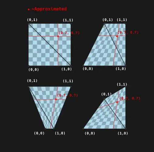

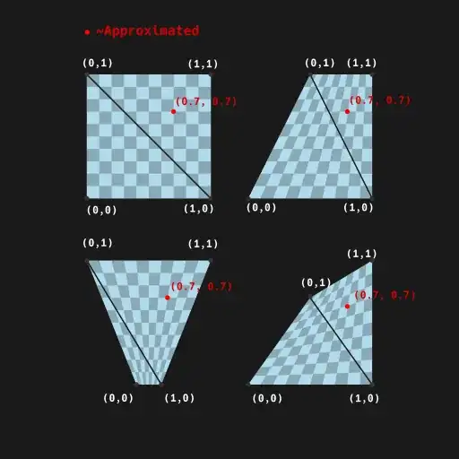

I'm trying to get the relative point position on a quad using a [0,1] Vector2, like in the picture below:
Quads and Positions
The red dots are relative positions.
What I'm trying to make is a function that takes the A,B,C,D vertices, the relative position and return the local position of point.
Example using the first quad of the image:
// Returns Vector2(7, 7)
GetPositionOnQuad(Vector2(0.7f, 0.7f), Vector2(0,10), Vector2(10,10), Vector2(10,0), Vector2(0,0))
What are some ways of doing this?

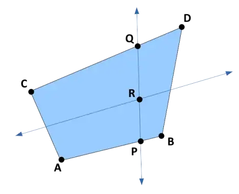

Assuming that your quad is convex, you can solve for an interior point using a few linear interpolations (lerps) between the corner points of the quad.
To illustrate, consider finding a point (R for result) at (0.75, 0.5) within the interior of a quad with points A,B,C,D ordered as given in your description. Intuitively, we know that the result is going to be somewhat to the right of the middle. How can we find that?
First consider the simpler case of what would happen if we were looking for (0.75, 0.0). In that situation we would want the point (let's call it P) that sits 75% between A & B. We can find P by lerping between A & B. Similarly, if we simplified to the other extreme of (0.75, 1.0), we would find a point (let's call it Q) that's 75% between C & D. Much like before, we can find Q by lerping between C & D.
But we didn't actually want either extreme, we wanted something between them, something that accounts for the second parameter as given. Again, we can find that by lerping between the intermediate points P & R. In this case we wanted to be 50% between them.
Here's a general illustration:
diagram of quad & interior points
In terms of code, you might have something like this:
static float Lerp(float a, float b, float t)
    return a + t * (b - a);
static PointF Lerp(PointF a, PointF b, float t) { return new PointF(Lerp(a.X, b.X, t), Lerp(a.Y, b.Y, t)); }
static PointF PointInQuad(PointF t, PointF a, PointF b, PointF c, PointF d) { PointF p = Lerp(a, b, t.X); PointF q = Lerp(c, d, t.X); return Lerp(p, q, t.Y); }

    It looks like you're answering "given a point in the 0-1 square, how can I find the corresponding point in the arbitrary quad?" but to my reading, OP is asking for the opposite: given a point in an arbitrary quad, how can they find its relative proportional coordinates in the 0-1 square? Your method is also more complicated than it needs to be: you can do this with three lerps, no line intersections needed. – DMGregory May 20 '22 at 11:58
  • @DMGregory I had already started to work up a 3 lerp style answer, but reading your comment about the directionality has me second guessing inputs & outputs as my read seems to mirror the logic of the above answer. How does Mangata's code not match OP's sample I/O? – Pikalek May 20 '22 at 14:48
  • I'll grant that I could be misreading it. I find the phrasing of the post unclear in how it defines "relative position" vs "local position". – DMGregory May 20 '22 at 15:20
