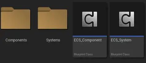

All components/systems are derived from these 2 ActorComponent classes and live in their respective folders:

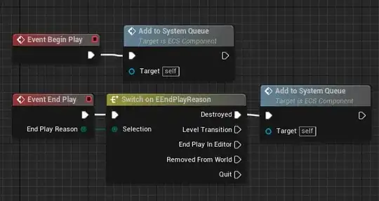

When an ECS_Component is added/removed from an actor in the world, that actor is stored in a global queue for the next frame to process.

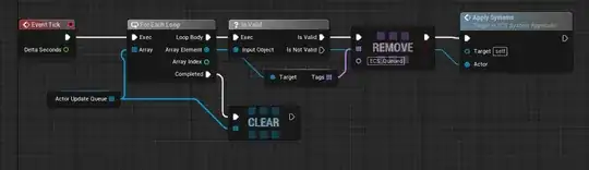

Every tick, the global queue is processed against a list of registered ECS_Systems and then cleared. Essentially, ApplySystems will be called on every actor that had a change to the ECS_Components that were applied to it.

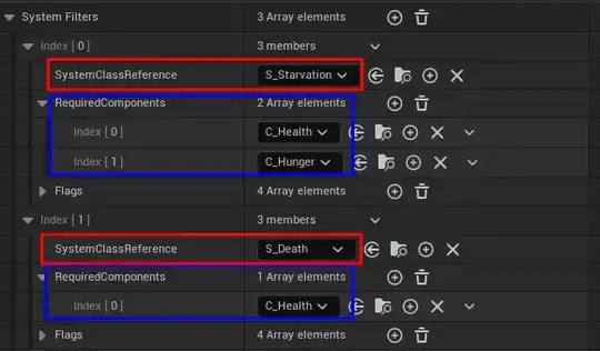

ApplySystems checks the required ECS_Components for each ECS_System (using a set of 4 int64 bitflags & bitmasks, supporting up to 255 components) and if the actor has those components, then that ECS_System is added/removed from it.
The function is a bit too big to post here. Basically, it loops through all the components on the actor and generates a bitflagged set of int64's. Then it loops through every system in the game and checks via bitmask to see if the actor should use the system.
The result; all system logic only runs on actors that have the required components. When a component is added/removed, the actor gets updated to ensure it has the right systems at all times. And this works! I successfully created basic health, hunger, and follow systems with this.
