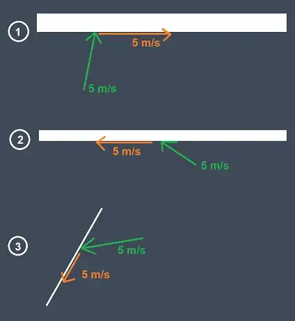

I was reading this answer, and while it works for that use-case, mine is slightly different (simpler?), but I can't figure out how to do it.
What I'm looking for is a way for the player to retain their speed. That is, if they are running into a wall at 5 meters per second, then when they collide with the wall, regardless of the angle they hit the wall, they will slide along that wall at 5 meters per second.
I've illustrated an example of what I mean in the following picture:
The green arrows are the player velocities, the orange arrow is what I want the resulting velocity to look like, and the white lines are the rectangles the player is colliding with.
Is there a way to do this? If so, how? Also, does it require the dot product? My intuition is that it shouldn't, because we want to maintain the player's speed, but I'm not sure.

  • You can follow that answer and do something extra : 1. Normalize the result vector. 2.Multiply it by magnitude of the original vector. – Mangata Apr 15 '22 at 12:45
Using the Dot Product
To begin, we reject the vector from the normal. I mean to subtract from the vector its projection over the normal. The vector projection looks like this:
Vector project(Vector a, Vector b)
    return b * (dotProduct(a, b)) / (dotProduct(b, b));
However, if we know we are projecting on a vector of already 1, then dotProduct(b, b) is 1. So we are left with:
Vector projectOnUnitVector(Vector a, Vector b)
    return b * (dotProduct(a, b));
So we are going to do this:
Vector undesiredMotion = normal * (dotProduct(input, normal))
Then we subtract, which leads us to the accepted answer of the linked question:
Vector undesiredMotion = normal * (dotProduct(input, normal));
Vector desiredMotion = input - undesiredMotion;
And then we can normalize the result and scale it to the length we want, like this:
Vector output = normalize(desiredMotion) * length(input);
