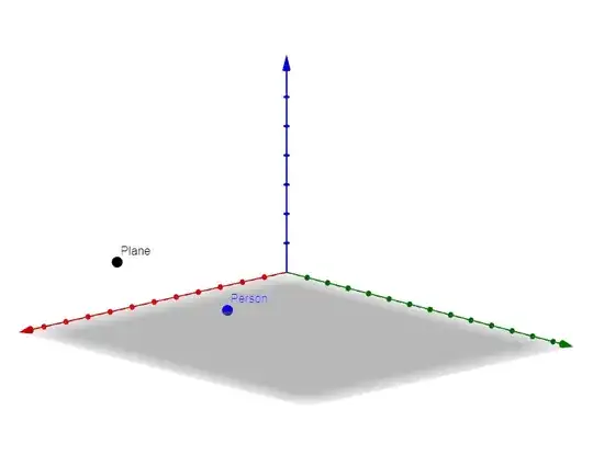

I want to calculate the time that it takes to intercept a moving target "plane" with a projectile.
For example I have two 3 dimensional vectors (2 locations in 3D space).
Vector3 Person = {100, 0, 50};
Vector3 Plane = {200, 50, 100};
Chart of these two positions

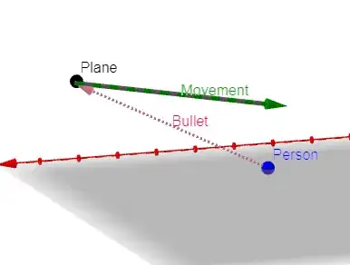

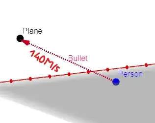

Now let's suppose the person has a gun that fires a projectile at 140M/s in a straight line with no acceleration or bullet drop.
Bullet course
I want to hit the plane, which has an initial velocity and a constant acceleration.
Vector3 VelocityPlane = {-10, -10, 0};
Vector3 AccelerationPlane = {0, -10, 0};
Plane trajectory
So what do I want to do:
Using the above information, I want to calculate where I should aim to hit the Plane.
