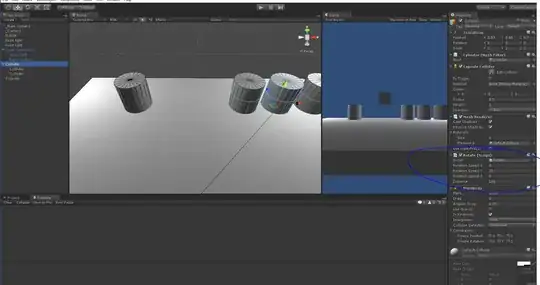

I'm working on a 3D game, and having issues with the colliders.
My Cube Controller has movement input by keyboard, with collider and rigidbody components.
Cylinder objects have basic colliders and rigidbodies attached. The main cylinder has a custom script that rotates the child objects (which have colliders and rigidbodies attached). Rotation script is a basic vector transform on the y axis.
When the Cube collides with the stationary cylinder, it collides as expected. However, when the Cube collides with the rotating child cylinder, there is a mixed variation. Moving in opposite direction collision allows the Cube to fall through the Cylinder collider; moving in the same direction causes the Cube to collide normally.
Can anyone help explain how and why this type of behavior happens, and what I can do to correct it?

And here is how it is configured on my main cylinder:
