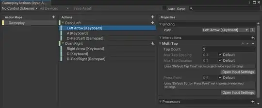

In your assets folder, right-click and select Create -> Input Actions, and set up an Input Actions Asset something like this:
Example Input Actions Asset
Note that I've made two logical actions for Dash Left and Dash Right. Each one is set up as a Button-type action, and listens to three bindings: keyboard arrow keys, WASD keys, and the D-Pad of a gamepad. Already the game is supporting multiple input types out of the box, with no extra code on our part. And, these are also easier to remap if you want to add that feature in future. Each of these bindings is configured to fire on "Multi-Tap" using the project default settings - so you have one place where you can tune every double-tap timing at once, uniformly.
You can add more input actions to the list, or even add alternative mappings for menus or different modes (like if your character can switch between forms or vehicles that need their own distinct controls).

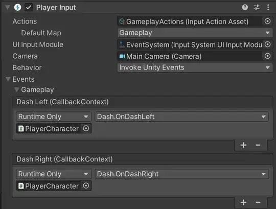

Now add a Player Input component to your character object, and set its Actions to use the Input Actions Asset and Gameplay mapping we just created.
Set its Behaviour to "Invoke Unity Events", and wire up the Dash Left / Dash Right gameplay actions to invoke our DashLeft()/DashRight() methods, respectively.
Configured Player Input component
And there we have it. Dash on double-tap, without having to manage button mappings and press intervals in our own code. This style is much more robust to future changes than the YouTube example, and as a bonus, its distance variable actually measures a distance in worldspace units!
