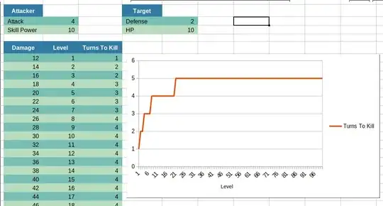

Then let's look how the damage becomes obsolete with leveling. Assuming same Character and Enemy level. Let's look at the turns requiring to kill a foe. Note: if your game is real time, it's possible to extrapolate damage per turn to damage per second.
simpler damage formula
The same foe, as long as levels match, takes more turns to be killed by the same skill in late game.
Your game may or may not be OK with this.

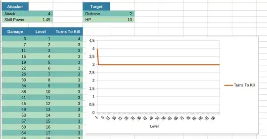

Now let's hack the damage formula. We can make Defense a division, but for simplicity, let's change one thing at a time.
Damage Formula:
if DamageType == "Physical":
   Damage = Character.Attack * Skill.Power - Target.Defense
multiply power
Ignore that a level 1 it takes 4 turns to kill the foe. That's a rounding artifact. I forced all damages to round down, and all turns to round up.
What that graph shows is that, as long as there aren't other factors like equipment (armor/weapons) at play, the same foe, as long as levels match, will die in the same amount of turns.
I think that is a lot more "elegant" from a mathematical point of view. I like more this damage formula.
