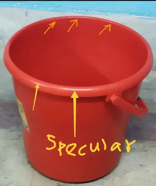

Let us consider the situation where only we moved the camera.
The object and the light source remain in the same place. Thus the angle of the incident light is the same for every point.I have captured one image where 5 arrows marked as specular reflection (from one particular camera position) and rest of the portion could be treated as diffuse: enter image description here But when I change the camera position (but object position and light source position remain as it is) the specular portion becomes diffuse and vice versa in the image of that object. But we know that diffuse reflection is independent of camera ( only depends on normal and direction of incident light). My question is how diffuse reflection is failing to show same intensity from all direction?
I want to share my understandings why this is happening, don't know my postulation is right or not:
  1. When we see diffuse and specular reflection is happening on one single object then the definition of diffuse reflection isn't going to work but when only diffuse reflection is happening on one single object then definition of diffuse reflection has properly worked.
  2. When we see diffuse and specular reflection is happening on one single object then diffuse reflection is also dependent of camera like specular reflection.Then when the angle between viewing direction (camera) and reflection is increasing then specular portion gradually converging to diffuse.
I believe we have gone over the fact that the position of the specular highlights depends on the position of the camera, the object and the light source. Thus, moving the camera is sufficient to move the specular highlights. The last paragraphs of a prior answer are about that.

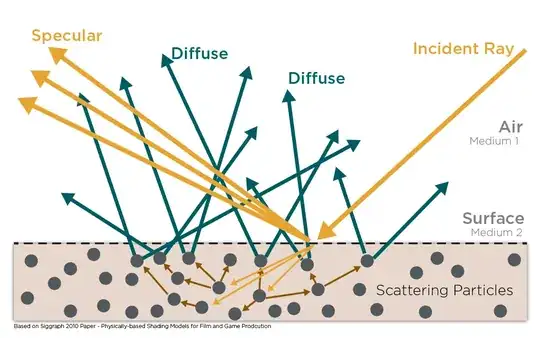

A light ray travelling from one medium to another scattering inside the object
A light ray travelling from one medium to another scattering inside the object. This picture is taken from the article THE PBR GUIDE BY ALLEGORITHMIC - PART 1.
So, some of the light gets refracted and scattered back out the surface. And the distribution of the direction and intensity of that light is close to uniform. So we model it as being the same from every direction.

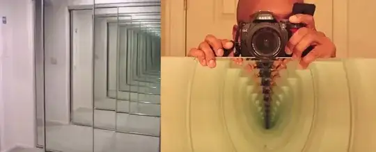

However, even mirrors have some diffuse reflection. It just happens to be very, very, hard to notice. But we can make it more evident by making repeated reflections, by reflecting a mirror in a mirror.
Mirror in mirror reflection
Picture taken from the video What Color is a Mirror by VSause.
We observe that the repeated reflections are less bright, and have a tint. Usually a green tint, due to the chemistry of the glass.
