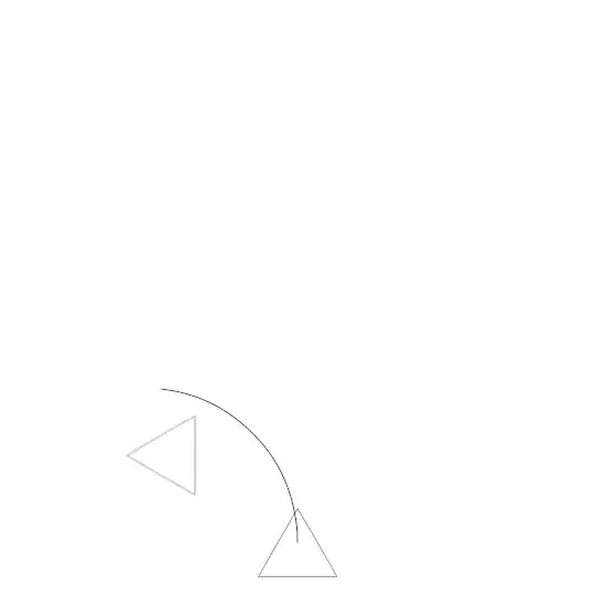

  2. Ships have a maximum turn rate. This combined with the set forward velocity means ships can't take turns with turn radii smaller than a certain value. Meaning there will be many target positions (+ orientations) that can not be reached with a single turn and ships will have to take a detour to reach them. A very rough and quick illustration: Say we have a ship at a current position with some rotation and we are given a destination location(+ orientation) that is too close to reach with a simple turn using the ships maximum turn rate:

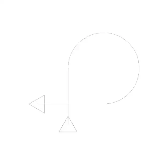

I now want to find the shortest path that does reach the target position and orientation. Which might look something like this:
Some position may require even more turning where recognizing / finding the shortest path is no longer trivial.
