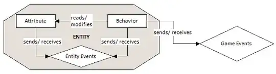

You already accepted an answer, but here's my stab at a CBS. I found that a generic Component class has some limitations, so I went with a design described by Radical Entertainment at GDC 2009, who suggested separating components into Attributes and Behaviors. ("Theory and Practice of the Game Object Component Architecture", Marcin Chady)
I explain my design decisions in a two page document. I'll just post the link since it's too long to paste it all here. It currently only covers the logic components (not the rendering and physics components as well), but it should give you an idea of what I tried to do:
http://www.pdf-archive.com/2012/01/08/entity-component-system/preview/page/1
Here's an excerpt from the document:
Attributes and Behaviors in Short
Attributes manage one category of data and any logic they have is limited in scope. For example, Health might make sure that its current value is never greater than its maximum value, and it can even notify other components when the current value drops below a certain critical level, but it does not contain any more complex logic. Attributes are dependent on no other Attributes or Behaviors.
Behaviors control how the entity reacts to game events, make decisions, and alter the values of Attributes as needed. Behaviors are dependent on some of the Attributes, but they cannot directly interact with each other – they only react to how Attributes’ values are changed by the other Behaviors and to the events they are sent.
Edit: And here's a relationship diagram that shows how the components communicate with each other:
Communication diagram between Attributes and Behaviors
An implementation detail: the entity-level EventManager is only created if it is used. The Entity class just stores a pointer to an EventManager that is initialized only if some component requests it.
