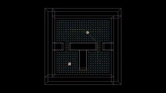

Currently my very basic AI framework has agents that move along a a jagged path made up of a series of points.
nav path
They do this by simply moving their position from one point to the next. When they reach the next point they move towards the next and so on. How can I change this so that they move smoothly along a curved version of the path, and how do I generate the curve?
