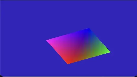

When I initialize _orientation with a rotation of 0, the program acts as normal but when I initialize it with 45, it warps the rectangle: Warped rect
and when I do it with 90, it produces the same result as with 0, which shouldn't happen. I'm assuming the problem lies somewhere in the way I'm applying the rotation to the object, but I have no clue what it is.

  • The way the resulting picture looks, it seems the problem might appear because you apply the translation step before the rotation. If you think about how the operations work, if you translate first then rotate by the coordinate system's Z axis (i.e. not the rectangle's center since it is now translated away from the origin $O = (0,0)$) then it will rotate the whole rectangle around the origin $O$. It might be possible that this is what you want but I think in your case it's not what you are trying to achieve. – PentaKon Nov 04 '21 at 19:22
  • How would I go about rotating around the center of the rectangle? I was thinking that if I give each object an orientation it would be rotated around itself, but from what you're saying that doesn't seem to be the case. I tried switching the order of the translation and rotation operations but all I got was each vertex moving around in a random pattern independent of eachother like the menu text in Persona 5. – CaptainLupa Nov 04 '21 at 19:46

  • Can you show us how you've set up your camera's viewport/projection matrix? It's possible the distortion is arising from the projection, and the rotation is just making it more noticeable. – DMGregory Nov 05 '21 at 12:30
  • I haven't set up a view or projection matrix as of yet, its just the modelMatrix multiplied with the vertex positions. Would that be the problem? like its getting squished by the aspect ratio of the window or something. – CaptainLupa Nov 05 '21 at 14:01
  • "like its getting squished by the aspect ratio of the window or something". Yep, that'd do it. You need to output your projected vertex positions in "normalized device coordinates" which range from (-1, -1) in one corner to (1, 1) in the opposite corner. If your window is twice as wide as it is tall, then a 1x1 square in NDC becomes a 2x1 rectangle in window pixels. And a tilted square becomes a skewed diamond. Your projection matrix needs to compensate for the aspect ratio of the window to fix this. – DMGregory Nov 05 '21 at 20:27
  • Alright I seem to have gotten most things working, thank you so much for your help. Also sorry I dissapeared for two days I didn't get any notifications any new comments had been added. – CaptainLupa Nov 08 '21 at 23:19

Alright so the main problem was actually that I had to projection matrix that changed depending on the aspect ratio of the window that was being rendered to. So with that out of the way I actually did end up getting quaternion rotations to work:

  • @PentaKon Check the end of the comment thread on the question - it looks to me like this isn't an issue with the rotation at all, but with the projection of the object coordinates into normalized device coordinates. OP is not using a projection matrix to compensate for the aspect ratio of the window, so using a window wider than it is tall stretches the image sideways. Any advice you can offer to OP in that situation? – DMGregory Nov 06 '21 at 13:52
  • @DMGregory Based on the above comment thread and if my understanding is correct, if your viewport's aspect ratio is not 1:1 (which based, on the blue background, it isn't) you must handle it in your projection matrix (which, based on this wiki page: https://en.wikipedia.org/wiki/Orthographic_projection, seems to have mistakes in its creation). I shall edit my answer tomorrow but the basic premise is that you have to divide the x coordinate of each vertex in your vertex shader by the viewport aspect ratio. This should give you a square in your screen. Hopefully DMGregory can confirm. – PentaKon Nov 08 '21 at 00:13
  • @PentaKon Aspect ratio wise, a perspective projection matrix seems to be working just fine, keeps the square square now. Now I just have to figure out how to apply local rotation to the camera for that sweet sweet fps cam :) – CaptainLupa Nov 08 '21 at 23:21
