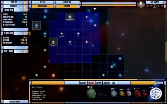

Just to give you an idea of what a WPF-based game UI might look like, here's a screenshot from my pet project:
Screenshot from my ongoing WPF-based game project
