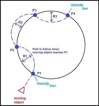

Further detail:
Scenario: The moving object moves with linear velocity until it reaches P1. When it reaches P1, I need to create the motion of the blue dashed path. Whilst the object follows the blue dashed path, it needs to uniformly accelerate from Velocity(start) to Velocity(end). Please note that the path is a rough sketch, in reality it should have smoother curvature without the abrupt changes in direction.
The following pieces of information are known:
  • Velocity (start), e.g. 5 m/s
  • Velocity (end), e.g. 10 m/s
  • The locations of the four points P1 - P4
  • The location of the centre of the circle
So far I have been able to successfully create a curve path by joining multiple bezier curves to form a spline:
But I do not know how to accelerate the yellow dot as it moves through the path. Any help would be really appreciated.

  • Can you tell us more about what kind of acceleration you want, and what degree of Bézier curve you need? Just evaluating a Bézier curve naturally comes with acceleration, and you can think of a cubic Bézier as a linearly-changing acceleration from an incoming velocity to an outgoing velocity. Try telling us a bit about what gameplay feature you're using this for in your game, and we can help you find the right curve and acceleration profile for that use case. – DMGregory Oct 17 '21 at 12:17
  • Thanks for your comments guys, I have updated the original post. Please note that the shape of the path should be changeable. It is the the ability to create the acceleration through the path that I am really struggling with. Also when I say accelerating from one velocity to another, I mean that the magnitude of the velocity changes, so it should move faster, e.g. from 5m/s to 10m/s at a uniform rate. – Cato Oct 17 '21 at 14:10
