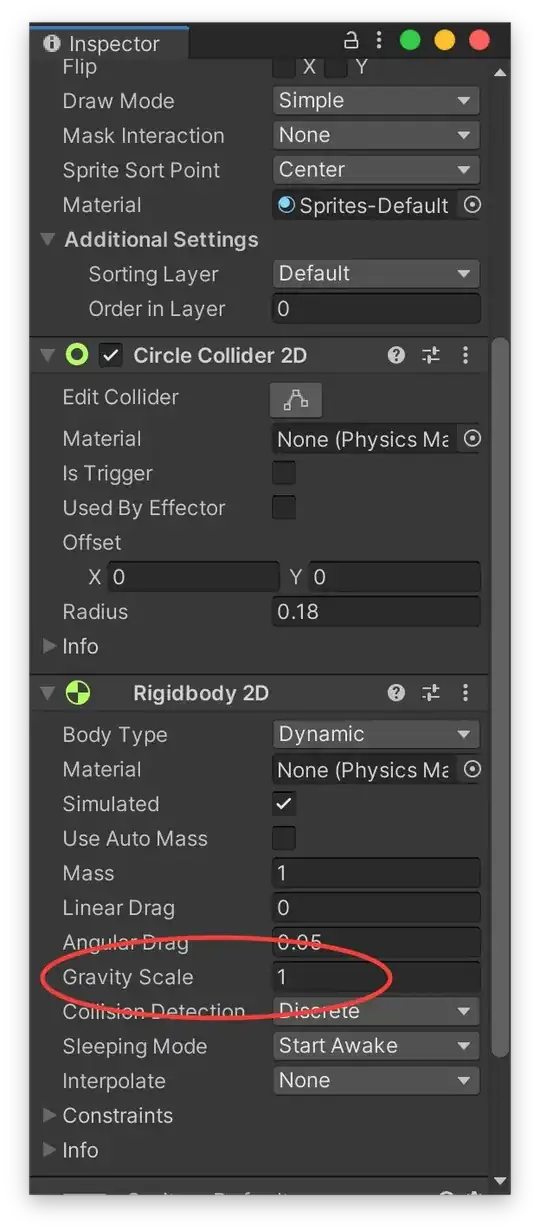

Increase Gravity
You could try increasing the gravity scale to offset the extra drag.
