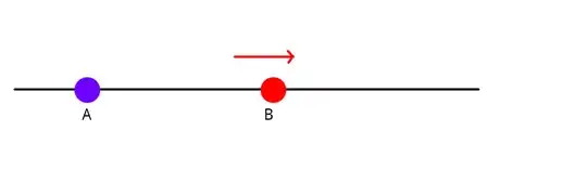

First, for my specific problem, we can assume we're working in a 1D space.
I have a point B moving at a specific velocity V. I want to smoothly move the body A so it reaches the point B and moves at the same speed, without oscillating too much. A could be behind or before B.
A is a physic body, on which is applied 2 forces, the thrust and the drag, so I don't directly control it's speed.
