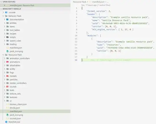

Once you've chosen and installed the text editor of your choice, the first thing you'll want to do is download the vanilla packs. The vanilla packs are going to be a point of reference for anything and everything (excluding scripts) that you may want to accomplish with your custom add-on. It is also recommended that you watch the official introduction to add-ons video.
Once you've downloaded the vanilla packs, feel free to explore their contents and get familiar with the structure:
Screenshot of the folder structure and an open manifest file in Visual Studio Code.
Note: I'm using Visual Studio Code in the screenshot above, but you can browse the folder structure in the file explorer or text editor of your choosing.

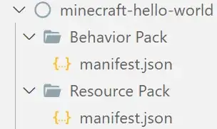

To get started, create a folder with the name of your add-on (I called mine Hello Minecraft) and then two folders within that one called Behavior Pack and Resource Pack respectively (henceforth referred to jointly as the pack folders). Within the newly created pack folders, create a file named manifest with a file extension of .json. The resulting stucture should look like this:
Screenshot of the basic file structure in Visual Studio Code.

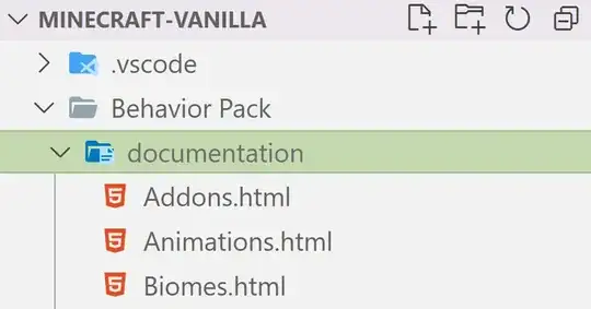

Now that you've created your first custom add-on for Minecraft: Bedrock Edition, you may be curious as to what documentation is available to you. Fortunately, the vanilla packs include some basic, but official documentation within the behavior pack:
Screenshot of the documentation files within the behavior pack.
