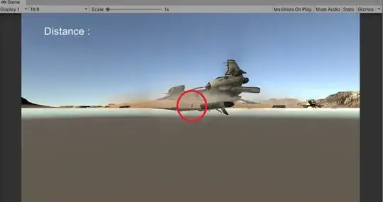

This is a screenshot showing the camera and the player distance when running the game :
The camera distance from player when running the game
but then when it's getting to the offset part in the Update this part :
offset = Quaternion.AngleAxis(Input.GetAxis("Mouse X") * rotationSpeed, Vector3.up) * offset;
transform.position = player.position + offset;
Then this happens :
The camera is too far from the player the player is marked with red circle
I marked with red circle the player to show how fat the camera is from the player.
