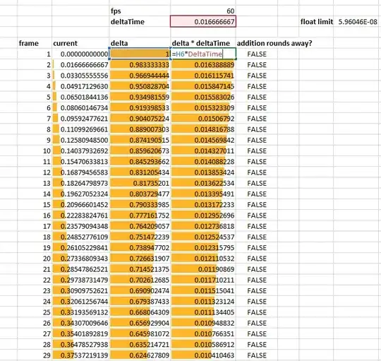

More seriously, you can plug your formulas into a spreadsheet to see for yourself:
Spreadsheet example
As current gets closer to target, delta gets closer to zero (and multiplying by deltaTime makes it smaller still, but does not actually help make this calculation framerate independent). So you add less and less of an increment every frame, making slower and slower progress.
After 42 frames at 60 fps, you've made it halfway to the target, but after another 42 frames, you're still only 75% of the way there (you crossed only half of the remaining half), and another 42 frames later you're only 87.5% of the way there (you crossed only half of the remaining quarter).
If you keep taking these 42-frame steps, each covering only half the remaining distance, you'd need an infinite number of such steps to actually reach your destination - otherwise after a step of size x you'd always still have another x distance left to go. At least, that would be the case with unlimited-precision real numbers.
But computers don't have unlimited precision, so you hit an even harder wall. Single-precision floating point numbers have 23 bits of mantissa. That means that close to our target of 1.0, we can only represent numbers in increments of \$2^{-23}\$, or about 0.000 000 119 209.
If the increment we try to add to current is less than half that number, \$2^{-24}\$ or 0.000 000 059 604, then it doesn't take us far enough to round to the next representable number, and current stays the same after the addition - it's like we added zero. At that point, our progress stalls completely.
That happens by around frame 748, or about 12 seconds of running this code at 60 fps.

  • Just noticed there's an error in the above. We can represent numbers slightly above 1 to a precision of $2^{-23}$, but slightly below 1 we can represent them to a precision of $2^{-24}$. The same argument applies, just at where our delta falls below $2^{-25}$ instead, which will change the frame number where we hit the wall. – DMGregory May 29 '21 at 01:09
