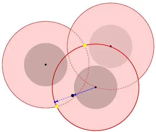

If you take each circle that's already been placed, and expand it by the radius of the one you want to place. Together, these circles form an "exclusion zone" - places where the center of your new circle cannot go without overlapping one of the circles already there. I've visualized the exclusion zone in pink created by the grey circles below. The big black dot is the center of the map we want to try to place our new circle close to.
If the target point we want to approach is inside this pink exclusion zone, then the closest our new circle's center can get is somewhere along the perimeter of the blob these exclusion circles form together. I've highlighted that perimeter in red. We'll check each arc on that perimeter to find our closest point.
To speed up out checks of what is or isn't in the exclusion zone, we can divide our map into a grid of buckets. Above, I've chosen the bucket size to be \$\sqrt 2 \cdot r_\text{min}\$ where \$r_\text{min}\$ is the smallest radius of any grey circle. This means that there can be at most one grey circle center in any bucket, and we only ever need to scan a fixed set of buckets around our test point to find all the exclusion circles that could exclude it - no matter how many circles there are in total.

  3. Next we'll find the point along the parent circle's circumference that's closest to our target point, by projecting the line from the parent's center through the target out to the exclusion radius. (Note that this point might not be on the outer perimeter of the whole blob - we'll check that next)
Closest point on perimeter
toTarget = target - parentCircleCenter;
closest = parentCircleCenter + toTarget.Scale(parentExclusionRadius / toTarget.Magnitude());
  1. If this blue point is not the closest candidate we've found so far, we give up on this circle. No other point on its perimeter will be any closer. So we grab the next circle off the open set and repeat from 2. (Note that this can't happen for the first circle we check, since we have no better candidate so far)
  2. If the blue point is the closest we've found so far, we check whether it's inside any other circle on the exclusion zone.
    If not (like the example on the left), then we record it as our best candidate and continue to the next circle in the open set.
  3. If the blue point is inside another exclusion circle (like the example on the right), then we walk through each other exclusion circle it's a part of. We'll call these "child circles" to distinguish them from the parent we started with.
    We'll skip over any child circles that are already in the closed set, to ensure we don't end up going in a loop checking the same circles over and over.
  4. As we check each child circle overlapping this blue point, we add it to the open set if it wasn't in it already.
  5. We find the two points of intersection between the child circle and the parent circle - you can use the formulas here for that.
    Intersection points
  6. We check if either of these two intersection points is closer than our best candidate so far.
    If so, we check whether this intersection point is excluded by any circles other than the parent-child pair we just looked at. If so, we add that neighbouring circle as another child to check. If not, then we log the point as our best candidate.
    Once we've looked at both intersection points and either logged them as our best candidate or rejected them as worse / excluded, we continue to the next child circle in 6.
  7. Once we run out of child circles to check, we examine the next circle in the open set in 2 - giving us a new parent circle.
  8. Once we've emptied the open set, we're done. The best candidate point that we've found is the best possible.
Note that unlike a randomized approach, this route is guaranteed to find the closest point there is, and that it will do so in a bounded number of steps, linear in the number of circles we need to avoid (we do a bounded amount of work per circle added to the closed set, and we add each circle to the closed set only once).
