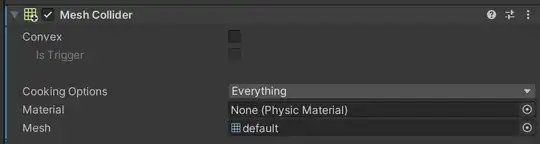

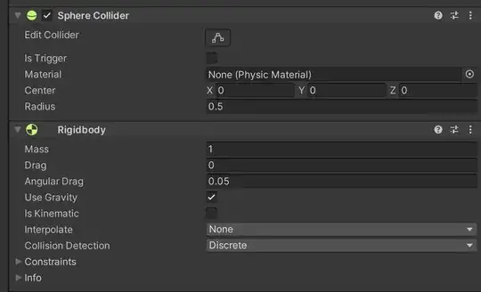

I'm trying to make a game where you play basketball as a catapult. Obviously an idea like this leans heavily on the unity physics engine. The cup of the catapult has a bucket on it to keep the ball from falling out. When you hit space, the arm of the catapult spins, which should throw the ball out of the bucket of the catapult. Instead, the ball passes through the cup of the catapult(when it isn't spinning, it acts normally and rolls around the bucket) and then it doesn't fall whatsoever, eve though has gravity is enabled. Here are my physics settings:
The ball

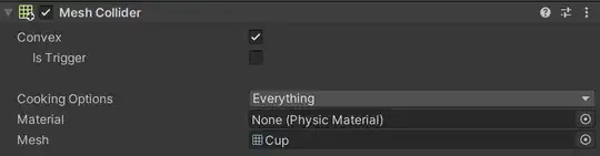

The cup(and also a cup with flipped normals)
The Rim of the bucket

  • You're making the classic mistake of teleporting objects with the Transform component, bypassing the physics system, and expecting the physics engine to come clean up that mess on the next tick. By then, it has very little information about what you wanted to happen - it just sees some objects teleported around, with no velocity or angular momentum sweeping them through that motion - so all it can do is nudge things out of intersection and hope that's what you wanted. If you want physical behaviour, you need to talk to the physics engine. – DMGregory May 09 '21 at 13:11
  • Also, if you want something to function as a "cup" then you definitely don't want it to be convex. A cup is concave by definition. – DMGregory May 09 '21 at 23:23
