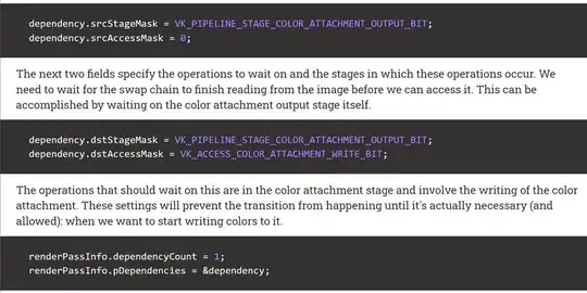

And I found something weired: enter image description here
How does this subpass dependency guarantee the layout transition(from UNDEFINED to COLOR_ATTACHMENT_OPTIMAL)of swapchain image happens after present engine finish reading(or working on) this swapchain image?i.e.Layout transition of this swapchain image bewteen external and subpass0 guarantees to happen after the imageAvailableSemaphores is signaled.

After days of struggling with spec,I found this stackoverflow post that perfectly solved my question:
https://stackoverflow.com/questions/60339191/synchronizing-a-render-pass-layout-transition-with-a-semaphore-in-acquire-pres
