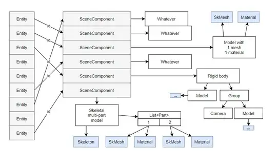

There is no point putting GFX assets into dedicated components:
  • Assets are allocated outside of a component, no cache locality boost.
  • Most assets are not involved in the ECS update graph anyways.
Components are better reserved for things that have a state that will be processed by the systems running on the CPU (e.g. skeletal and other animations) or must be exposed to those systems (e.g. current physical transforms).
But the compositional part of the GFX department (that consists mostly of the references to the assets and their combinations) would not benefit from the ECS designs, so there is no point shoehorning it into the ECS framework.
Just as with many (mainstream and not) engines, it makes sense to build a single ECS component for housing entire scene graph of an entity. It's a good fit for composing graphics, physics and other spatial components (such as cameras and triggers) together in a single tree.
Because a scene graph has no limits of ECS, you can do the composition the way that seems most natural to you. Do a single renderable that can combine multiple assets, or go for a full blown tree.
